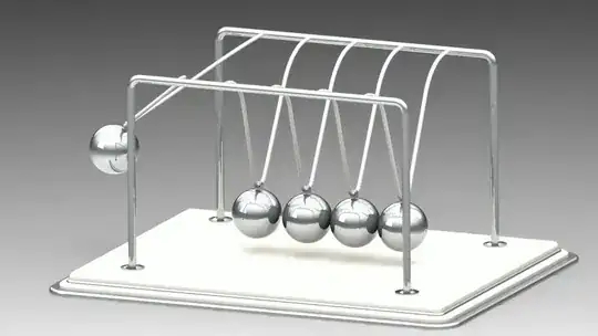

Is the effect similar to a newton cradle, where one ball knocks the first one and the force is transmitted through the chain?

    One of these days I'll have to write a canonical answer, but see https://electronics.stackexchange.com/questions/245610/is-voltage-the-speed-of-electrons/245621#245621 : basically your intuition that it's like the Newtons cradle is correct. For almost all purposes you should ignore electrons. – pjc50 Dec 31 '18 at 16:15
    The Newton's Cradle is a very good analogy. It's not exactly accurate, but it's a good way to conceptualize it. Note the "current" flowing from positive to negative is not based on any physical principle -- it would make more sense for it to flow the same direction as electrons. But "positive" and "negative" were defined before the electron was discovered, and they got it wrong. – Hot Licks Jan 01 '19 at 04:31
