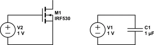

Edit: so the explanation is almost exactly your (1) with one detail different. Dirac16's hint is important. The gate-to-channel insulation has a capacitance. So the circuit looks like a capacitor. These two circuits are equivalent (ignore the values):
schematic
So there is no steady-state DC current flow, but at the point of connecting up the circuit the capacitor charges, and while it is charging a current flows. This is actually quite important when designing power MOSFET systems: you need to be able to supply adequate current for a very short time.

  • Ok, that's a good place for me to start mentally. I appreciate you helping me approach this as a beginner. So, it sounds like the gate wires of a MOSFET may just be like the piece of ferrous metal attached to the pole of a magnet. They just extend that field out to the end of that gate wire and that's how the transistor switches states. But it does sound like the gate wires of a MOSFET require a current to produce the voltage. It's just that the current is flowing through the main part of the wire and not directly through that little offshoot wire going to the gate. – BarrettNashville Jan 13 '17 at 19:54
  • See edit - the MOSFET is a capacitor which requires a current to charge, which in turn requires a voltage to cause the current. – pjc50 Jan 13 '17 at 20:20
