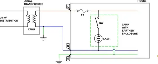

Figure 1. A local distribution transformer supplying a house with only one applicance in it - an electric lamp in a metal enclosure, properly earthed.
  • With reference to Figure 1, we can see that the local transformer isolates our supply from the generating station. Whether the generator is earthed or not is of no interest to us. (The transformer symbol indicates that there is no electrical connection between the primary and secondary sides.)
  • One side of the transformer is "neutralised" by connecting it to an earth rod driven into the ground. Neutral, as the name implies, means that this conductor is neither positive or negative. In ideal circumstances one could touch this wire without harm. (We'll see later why this isn't recommended.)
  • Everything in the house is wired between L (live) and N (neutral).
  • Non double-insulated appliances and fittings have their metal cases earthed (grounded).
Now there are a few things to note about this arrangement:
  • In normal circumstances all current is supplied on the live wire and returns on the neutral. (Yes, it's alternating but we can still think of it this way.)
  • In normal circumstances NO CURRENT FLOWS IN THE EARTH WIRING. It just sits there - maybe never being used ever - in case there is a fault.

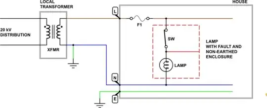

If we don't earth the appliances we could have a dangerous condition.
schematic
simulate this circuit
Figure 2. An unearthed appliance with an internal fault making the enclosure live.
Now if someone touches the lamp they are in danger of electric shock. This may flow through their body to ground by resistive conduction but since the human body has some capacitance with the Earth at least a small current will flow.

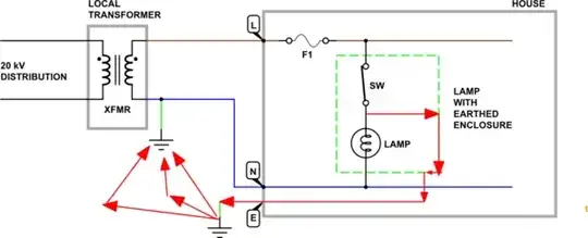

Figure 3. An earth fault.
In Figure 3 an internal fault has occurred.
  • Because the appliance is properly earthed the voltage on the appliance will be low.
  • If the fault is severe (a good contact between the internal live wire and the case) AND the ground return path to the transformer is adequately low, a high current will flow and the fuse will blow. This will render the circuit safe.
  • Note that since one wire has been neutralised we don't need to install fuses in it.

  • Way to end an answer :)...+1 in-depth. Just to clarify, 240V is across the secondary of the transformer, whether neutral has a local reference or not, and the main reason a local reference is set is to provide a return path for fault current from houses, since earth can be reached by all of them? Also you say "the voltage on the appliance will be low" under figure 3; i thought the voltage on the appliance remains the same but all that happens is that most of the current flows through the earth conductor, which has a much lower resistance than the human body; like really tiny parallel resistor? – SoreDakeNoKoto May 07 '16 at 00:37
  • In the second diagram the voltage will be low because the switch is off. – user253751 May 07 '16 at 04:12
    @TisteAndii: (1) 240 V always. Correct. (2) Main reason? Yes. (3) I didn't want to overdo the answer but consider a dead-short between live and earth on the appliance. The only resistance in the circuit now is that of the live wiring (from transformer to appliance) and the earth wiring (from appliance back through earth rod to ground). If these resistances were equal the voltage on the appliance would reach half-supply. The lower we can make the earth resistance the lower will be the fault voltage. – Transistor May 07 '16 at 08:34
  • @immibis: I think you meant Figure 3. I switched it on now. Thanks. (It was a cut'n'paste error. I remembered to toggle the switch in Figure 2 but forgot in Figure 3.) – Transistor May 07 '16 at 08:36
  • @transistor. Thx for the pics. Tough to get such concepts across in just words alone. –  May 07 '16 at 17:30
  • @Transistor, with respect to figure 1, if the other side of the transformer was not grounded as well, would current flow to the lamp from both ends of the transformer causing the lamp to explode? What would be the potential difference between the two ends of the transformer in such a case? – penguin99 Jun 11 '19 at 11:22
  • @noorav: Copy the circuit into a question, draw the second earth and use the arrows to indicate where you think current would flow. Remember that it needs a circuit - a loop - to flow. – Transistor Jun 11 '19 at 18:13
  • @Transitor, what do you mean by 'draw the second earth'? Are you referring to the grounding of one end of the secondary? – penguin99 Jun 11 '19 at 18:15
  • I may have misunderstood your comment regarding the "other side". I think it's still another question and a schematic will be better than words. – Transistor Jun 11 '19 at 18:33
