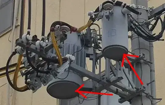

Attached below is an image of a Power transmission pole. What I am interested in is the cylindrical shaped objects attached to the transmission tower.
Some other observations and relevant information:
  1. These objects are not present in every tower but on one in every few towers or so.
  2. These towers are from a mixed Residential and commercial neighborhood
  3. The towers in question are in Japan. I have not observed these cylindrical objects on similarly sized transmission towers in my Home country
  4. A less relevant observation is that even though these are overhead transmission lines, they are insulated, perhaps because of the proximity of the houses and buildings to the towers
    EDIT: There is a similar question linked here, however, this picture has both a single phase and larger 3 phase transformer while this earlier question had only a single phase one. Further, the question uses different terminology to describe the transformer (cylinder vs canister)

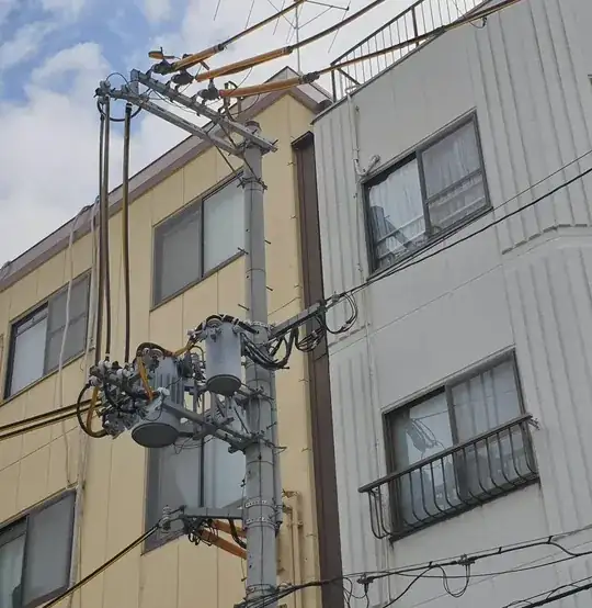

I'm assuming you mean these two:
The official name for these is "Distribution transformer".

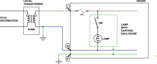

They are the "local transformers", here's a schematic of how they could be connected:
Which is from this question
Actual connections and voltages depend on the country so details may be different.

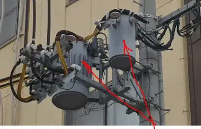

The large cylindrical devices as indicated below are power line transformers. Their function is to step down the higher distribution AC voltage down to the common mains line voltages that feed into residences and businesses.

The larger DT is 3 phase voltage stepdown, while the smaller one uses only 1 phase for local use residential use.
