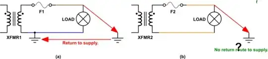

schematic
Figure 1. In (a) a L-E fault will cause current to return to the supply through the earth and, if high enough, will blow the fuse. In (b) there is no ground return path, the faulted wire will be neutralised but F2 will not blow.
No. Since there is no other reference to ground no current will flow. Instead the point now connected to ground has been "neutralised".

No, current doesn't particularly want to travel to ground. If you have an isolated power supply, and connect one terminal to ground, the current flowing will be very small.
