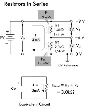

  1. What's the point of having the ground near the negative terminal when the electrons would just then flow out of the circuit into the ground?
  2. Since there is already a potential difference between the positive and negative terminals, what's the point of a ground at all?
For example:
Why would ground be on the right? That means in technical current direction, the current would go to the ground and not to the negative terminal and there would be no potential between the ground and the negative terminal...

Ground defines where 0 volts is. So you cannot place it at the 'negative' terminal, otherwise it would be 0 volts.
For example, if you place 0 V near the '+' side of a 9 V battery, that side will be 0 V, and the '-'side of the battery will be -9 volts. If you place the ground near the '-' side (normal way), than the '+' side is +9 volts and the '-' side is 0 volts.
If you place two resistors in between the '+' and '-' side and place ground between the two resistors, than (assuming the resistors have the same value), the '+' side will be +4.5 volts, the ground in between the resistors 0 volts and the '-'side will be -4.5 volts.

  • Right but what about my example? Ground near the negative terminal would make the current go through the ground and not to the negative terminal. – mikanim May 17 '19 at 19:40
No, if you measured the current with a meter on ground, you would find that there is no current flowing from this circuit to earth. Why? because all currents must flow back to the battery. A current needs a loop and current flows back to the source.
In this case, for reference. If this circuit was detached from ground, you wouldn't know what the voltages were with respect to ground. It enables you to call 0V the same as earth ground. This can be nice if you have other devices that are connected to ground. If this circuit is in the air, the whole circuit could be floating to different voltages (but they would be the same with respect to each other. In calculations, you need a ground, if there is a system of equations, you need a zero point or it becomes difficult to solve the system of equations.
It doesn't need to be, you could put it anywhere in the circuit, the voltages would be different (relative one to another) but the currents and powers would all be the same.
It would be a great exercise for you to solve this circuit by putting the ground at different points and solving for all voltages and currents.

Term ground in circuits generally doesn't mean earth. It's only a name, a point which is the reference point for the voltages of all other points in the circuit. All voltages are between two points, but for convenience and making designs radically easier, we generally have one point named GND. Then we can easily write "this point XXX has voltage YYY volts". Physically YYY volts is still between XXX and the agreed GND and a voltmeter to see it must be connected between XXX and GND.

Just to address one of your misconceptions in the comments:
If electrons are not being "sucked away" to a true earth ground, what is making electrons go to an earth ground from, say, a house? Especially when the earth is assumed neutral.
  • Stop thinking of "electrons". Think of current.
  • Current flows in closed loops.
  • If the loop is open circuit no current flows.
  • There is only one earth connection on your circuit so there is no return path out through that connection and back to your circuit. Therefore no current will flow.
Electrons don't get "sucked away". Why do you think they would?
Current only flows in a house earth wire in the event of a fault.
