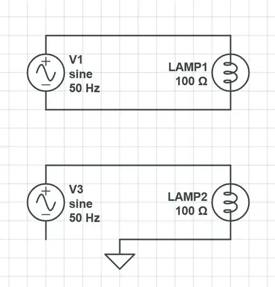

I learned that current must flow in a circuit (loop).
When I swap the N-wire with the PE-wire on a light bulb in my house, the circuit breaker trips as soon as I turn on the light. This tells me that current is flowing from the L-wire (from the power plant) to the the PE-wire that is connected to a long metal rod that is put into the ground just outside my house (as far as I know). So there is no circuit, no loop that leads back to the source.
To check whether current really needs to flow in a circuit (loop), I took a battery and connected the positive pole to a light bulb, and the light bulb to a PE-wire of my house. The light bulb did not turn on. When I connected the light bulb to the negative pole of my battery, it turned on because the circuit is completed.
When current must flow in a circuit (loop), why does it flow to ground? And why does it not work with an electrical circuit where power comes from a battery?

  • why does it flow to ground? It doesn't. You have add another ground symbol at the - connection of V3. Then current can flow and that net will be called "ground". You could call it "bimpel" or "Daniel" as well if you like. But using that ground symbol is a convention we EEs use to indicate that any voltage potential is referenced relative to that ground point. – Bimpelrekkie Mar 12 '21 at 14:41

Your PE and N are connected together at somewhere in your building or at substation. N is used for normal return and PE as the safety return. So both N and PE are at the same earth potential. The PE would be quite useless if it simply was going to metal rod pushed to soil.
And since a breaker trips, it should then be a RCD which checks that both Live and Neutral have equal current or then it will trip.
And yes, the two battery terminals need to be connected to the two terminals of the lamp via some wiring for it to light up. Current does not normaly flow via an air gap (except whn arcing).
Yes.
No, the ground fault circuit breaker is triggered because there is current flowing in a loop where it shouldn't be.
There needs to be a circuit. You have not described a circuit.
The term "ground" has two meanings. One refers to the
The other meaning of "ground" is simply a reference point in a circuit.
Current will only flow to an "earth" ground if the earth is part of a circuit. That is, there actually needs to be two connections to that earth ground.
If a battery powered circuit has only one connection to earth, then no current (from that circuit) will flow through the earth. The current needs to return to its source, which is the battery, and there is no return path through the earth.
