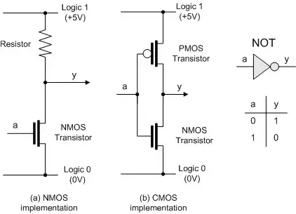

For bipolar logic like TTL this is correct; even for push-pull outputs ("totem-pole") only NPN transistors were used and \$V_{CC}\$ is indeed connected to collectors.
But for CMOS \$V_{DD}\$ is actually a misnomer. CMOS is much more symmetrical than TTL, and while the source of the N-MOSFET is connected to \$V_{SS}\$ it's not so that \$V_{DD}\$ is connected to the drain.
CMOS inverter
Due to the symmetry it's actually connected to the source of the P-MOSFET. This is probably an inheritance from NMOS, CMOS's predecessor, where \$V_{DD}\$ was indeed the side of the drain (with a resistor in between).

    Actually, the pull-up for an NMOS output pin would usually be another N transistor. Internal gates would often use a passive pullup (equivalent to resistor-transistor logic) but the output pins would usually be an NFET analogous to the high-side NPN in a TTL totem-pole output. Even passive pull-ups are often depletion-mode outputs rather than resistors. – supercat Jul 27 '11 at 01:07
