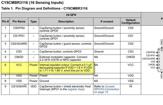

I have Cypress MBR3002 IC which has two power pins labelled VCC and VDD.
I got a question from my colleague about the reason behind two different names for two power pins.
According to datasheet, VDD is actual power pin and VCC is internal to the IC. At lower supply voltage, both needs to be supplied by external supply itself. At higher voltage VDD is internally derived by the IC using external VCC.

Most probably the needs for two different pins arises because that chip needs an internal 1.8V power rail, which is connected to Vcc. If the main power pin (Vdd) is powered with high enough voltage, the internal rail is derived automatically with an internal regulator block. If the Vdd voltage is too low, the internal regulator cannot work, so the datasheet simply tells you to join both pins together.
