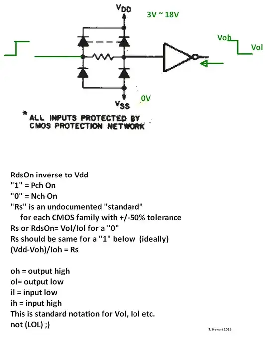

Perhaps this fills in the gaps to your knowledge of standard CMOS datasheets.
Generally CD4xxx series was high voltage and high impedance. > 300 ~ 1000 Ohm for RdsOn . Since both Nch Pch drivers conduct during transition they must be high impedance to reduce current spike between V+ = Vdd (drain) and V- = Vss (source).
Looking at all the dozen or so of CMOS families as they became faster, they limited Vdd max to use lower RdsOn which raises the current and thus speed from dV/dt=Ic/C from [pF] loads ( Miller cap and traces above ground plane)
As Logic families have migrated to lover voltages, they must also lower RdsOn ( which is a "cross-conduction condition).
This is why every CMOS IC needs a 0.01uF decoupling cap while TTL was every 10 IC's as transition current spikes are normal, limited by Rs and depends on number of similar CMOS inside are switching at same time.
From the Recommended Operating Conditions Tables
  • for 74LVxxx family is rated 2V to 5.5V
  • worst case 5V, - 10% =
    • at Vdd=4.5V Vol = 0.55V max @ Iol=12mA
    • thus output resistance is Vol/Iol = 550 mV/12 mV= 46 Ω (min.) (ref SN74LV393A)
    • this is how you can interpret CMOS drivers when loaded by some know resistance or capacitive loads for risetime or voltage shift from the rails.
