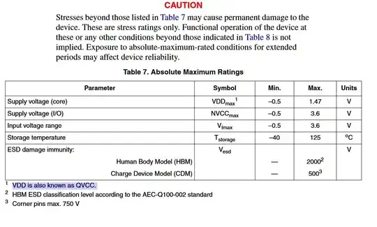

The datasheet is quite clear in Table 7 enter image description here
VDD (or QVCC) is for the core , NVCC applies to I/O pins ( for which there are N ? ) different VCC normal ratings specified shown in Table 8 for different I/O types.
