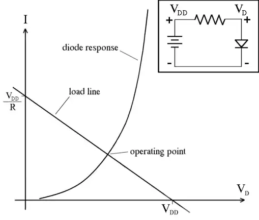

Your formula is correct BUT to do it properly you need to iterate the result (or use a simple graphical load-line method - see at end).
This is because LED forward voltage drop is non linear with current (or current is non linear with forward voltage drop. In many cases this effect is not significant, but in some cases it can lead to results which are 2:1 or more in error.

SH correctly commented:
The classical non-iterative method would be to take the LED's characteristic curve and draw a loadline across it so that it intersects the curve at the operation point the user desires. The slope tells you the resistance. People did this all the time in the vacuum tube era when there were no pocket calculators.
This is a quick and easy method which produces the same final result. Wikipedia
Simple & useful load line tutorial here
