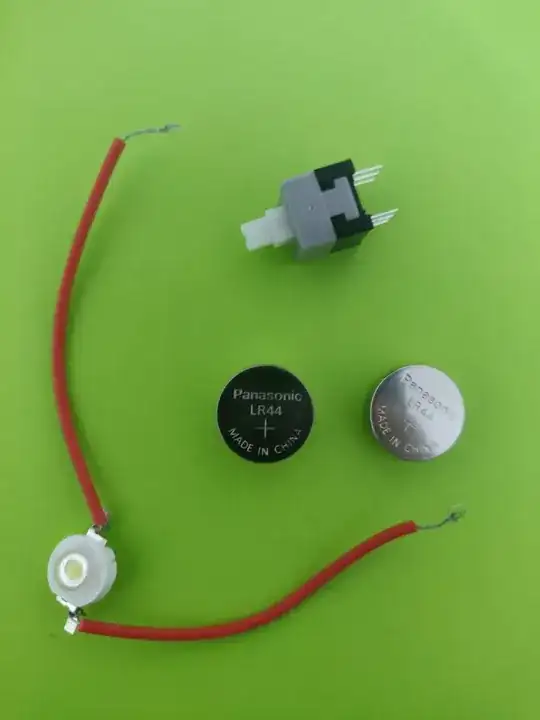

I tried to make a circuit, but the LED is still on even when the push down switch is turned off. I have attached some pictures.
Please tell me what to do. I come from an artistic background. I am trying to make a tiny cosplay pendant that I can sell, so please tell me if I have bought the right material, too. What kind of micro battery cell holder do I need for the two cells?

  • You are aware that this won't last very long using those little cells, right? Your 1 watt LED will need a lot of current. Those little cells can't deliver much current, and they can't do it for very long. Do you really need an LED that powerful? – JRE May 17 '23 at 15:08
    If the switch doesn't turn off the power you probably hooked up the wrong pins. – user1850479 May 17 '23 at 15:11
    Please use a multimeter in resistance or beep mode to find out which pins are switched and which are in parallel. – winny May 17 '23 at 15:24
  • The switch you have is usually two independent units; one of the pins at the end of each row is connected to one of the other two pins depending if the switch is pressed or not. However, from what you're describing, it's possible that you have a switch where the rows are just duplicates of each other and the first pin of each row is connected together, and the second, and the third. – vir May 17 '23 at 16:16

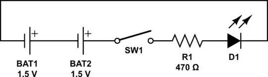

That one is easy: some of the pins on the bottom of the switch are always connected together. Use a multimeter "beeper" - or just the LED! - to figure out which pair works as you want it to. There will be at least one such pin pair.
The coin cells you're using have maximum of about 20Ω of internal resistance at room temperature, typically 1/3rd of that. Each cell acts as if it was an "ideal" cell with a 5Ω..20Ω series resistor added to it. That's why the LED didn't burn up as it would had you tried it with let's say two D cells and a red LED.
Since the (presumably) white LED has a fairly high forward voltage drop - above 2V - and can sustain high operating currents (>20mA) - there may be no need for an additional series resistor. Due to the cells' small size, though, you want the LED to be running at a low current - about 1mA maximum to have any reasonable cell life, and ideally less.
Thus it may make some sense to add a 220Ω..1kΩ series resistor anyway, just to make the cells last longer than a few minutes. Thus:
schematic
The smaller the cell, the lower brightness the LED should be operated at so it doesn't kill the cell prematurely - the lower the operating current it can take to extract most of the energy out of it. To lower the operating current, the series resistor's value need to be increased.
A reasonable range of series resistor values for a pair of LR44 batteries in series working with a white LED is up to 4kΩ or so. Above 4k&ohml the LED is not bright enough, and the batteries are operating well below their rated discharge current.
To be able to exploit the full rated capacity of those tiny cells, the discharge current has to be quite small, but making it much smaller than that gives not much improvement in longevity. The series limiting resistor may need to be above 1kΩ.
If you can measure the current, adjust the resistor so that the current is about 0.2mA. With discharge current at or below 0.2mA, the LR44 battery should achieve its rated 100mAh capacity. Currents above 0.2mA make the battery less efficient and wastes more energy as heat inside the battery instead of light :)

For a costume or "wearable" light, keeping things small and lightweight are usually of utmost importance. A couple of coin cell batteries like the LR44s you have is definitely in keeping to that principle, however they are really designed to power things like watches, hearing aids, and other low-power devices. Since you mentioned "pendant," I assume you want the batteries to be extremely small and housed in the pendant along with the LED.
The LED you've selected appears to be a high-brightness (and high-power) one, which will be far too demanding of the batteries you've selected. So you have an engineering decision to make:
  1. Do you want ridiculous brightness for a wearable that really shines? You'll have to increase your power supply (bigger batteries!) and probably have to run some small wires from somewhere on the person to the pendant. You may also have to consider how hot the LED will get over time and ensure that it doesn't fail from too much heat or even burn the person wearing the pendant.
  2. Do you want the batteries you've chosen to power an LED for a reasonable duration? You'll have to decrease your LED power demands (smaller LED!) and settle for less brightness. But not to worry, you can get quite a bit of brightness from very small, less power-hungry LEDs. For your purposes, consider something like the Adafruit LED "sequins", which are surface-mount LEDs on a tiny PCB that is aimed at making wearable electronics.
