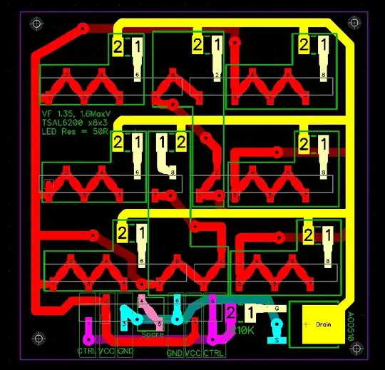

Can someone please review my PCB? Simply, I'm running 24 IR Leds at medium power, from a 5v arduino MCU pin, all pulsing together (38khz). Big fat traces, lots of space, SMD components. The LEDS are in 8 3-serial runs, and I have power/ground traces around. The "leds" on the board are just 2.54 headers, as I'll be running them off-board. But I don't know if I've got my head wrapped around the mosfet circuit correctly. Please be kind (but feel free to talk to me like an idiot, because I am) :) I'll fab at seeedstudio if it's relevant.

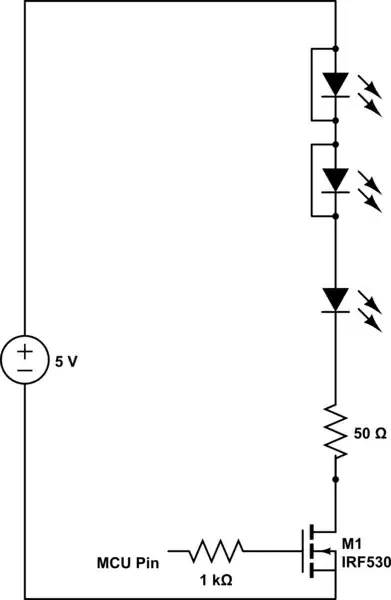

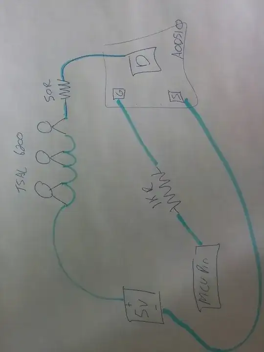

Edit: I believe this is the schematic for the board as is currently laid out (with the exception of lowering the gate resistor as a commentor suggested). Also, I do believe I'm an idiot with the leds, as I'm bridging their legs, rather than just the leds, so can remove those trace portions (ie on the top left led, 1 and 2 are the +- legs of an led so ought not be 'traced', but 2 and 3 need the trace to connect led1 to led2.):enter image description here
schematic
    A schematic diagram would be helpful... – Peter Bennett Dec 23 '15 at 03:08
  • Judging by the trace colours, you've got a 7 or 8 layer board (I lost count :-) ) I don't see any holes in what I assume are your header positions for the LED connectors, and have no idea what the red zig-zag patterns represent. – Peter Bennett Dec 23 '15 at 03:17
  • It's a 2 layer board, 90% on the topside. Nets are multicoloured - you can see where in a couple spots a net goes from red to darkred at a via as it goes to the other layer. The zags are the LEDs, 3 in series. And no holes - all smd parts, including smd headers. The MOSFET circuit is the main question. – dirtyharry2 Dec 23 '15 at 03:28
    My eyes are bleeding looking at that. – Ecnerwal Dec 23 '15 at 05:02
  • Are you current limiting the LEDs with resistors? Show the circuit. – Andy aka Dec 23 '15 at 10:53
    I added what I believe is the schematic for the board as drafted, to the OP – dirtyharry2 Dec 23 '15 at 18:50
    If your schematic is correct, and looking at your PCB, they seem to match. You have 2 of the 3 LEDs shorted out. – Tyler Dec 23 '15 at 19:00
  • Ha thanks, I was noticing and commenting/correcting simultaneously. Yes, the board's wrong in that fashion, but I can change those traces. If the mosfet's right, I'm close to fabbing. – dirtyharry2 Dec 23 '15 at 19:25
  • Your cct (and my Circuitlab redraw) does not match your layout. The layout has all the diodes in parallel WHILE the cct has them in series. Are they meant to be in series or parallel? –  Dec 23 '15 at 20:03
  • My PCB has 3 in series (8 times, parallel). I only drew the schematic for the one series. – dirtyharry2 Dec 23 '15 at 20:21
Whew, what a color-riffic board! That said, please try to use one color for each layer, such as red and blue. That's the "standard" way of doing it and most others will better understand it represented this way.

  • Thanks; I'll limit colors when posting. I found it helps me visualize the nets, but I get if others see it as nonstandard. As for the rest, it sounds like the MOSFET circuit is wired correctly to the MCU and LEDs then? You're just worried about kHz, and I can tinker with the pulldown resistor for that? I've seen so many schematics, all different, that I get confused. Some have some form of voltage divider and 1M res! – dirtyharry2 Dec 23 '15 at 05:05
  • It should work, if I can understand the wiring correctly, but the performance may not be exactly what you want. Just be prepared to tinker with it and make a few revisions. – rdtsc Dec 23 '15 at 17:05
  • I added what I believe is my current circuit in schematic form to the OP. – dirtyharry2 Dec 23 '15 at 18:49
