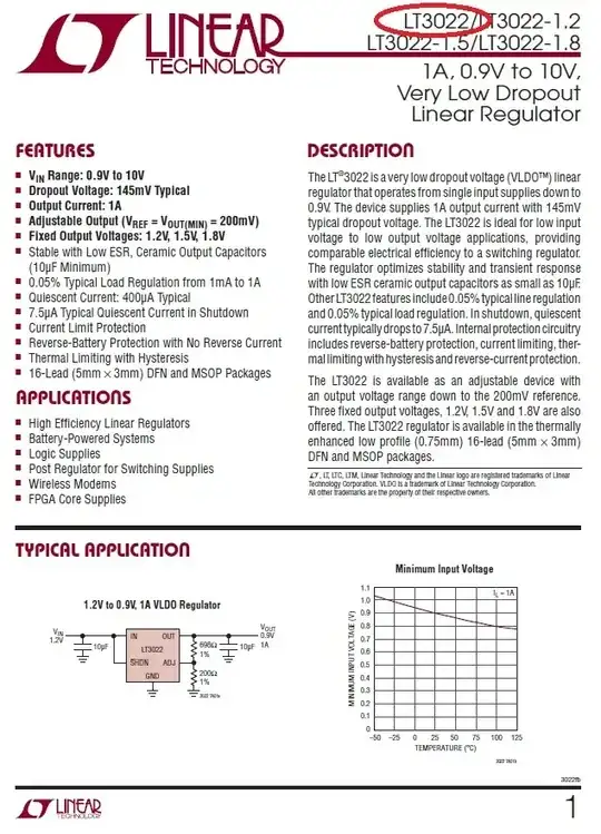

However I'd like a solution that can sustain 4.5V regardless of the current (within the limits above)
If you are happy with a constant voltage of 4.5V then you should consider a low drop out voltage regulator like this: -
It can be setup to deliver up to 4.5V and at 1A to the load and will only need 4.645V (typically) on the input to sustain the output voltage. Note that it needs a minimum load for it work correctly (1mA) but this shouldn't be a problem given your requirements.
This is typical of a series of many voltage regulators with low drop-out voltage - I'm not saying use this one - I am saying be aware of what TI and other folk may be supplying. It's likely you can find one with current limit circuits built-in. You could also apply a bit of current limiting in this device by having a resistor in series with the voltage feed - this should be chosen to develop just enough voltage across it (at the required load current) to sustain the output. Should load current increase, output voltage will drop.

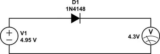

A silicon diode has roughly a 0.65V drop. Putting it in series with the 4.95V from USB will get you close to 4.5V:
schematic
An LDO will also work, and will have better regulation (voltage will vary less with current) and could be closer to 4.5V. But, there is no real such thing as exactly 4.5V and perfect regulation, only progressively better methods. A good engineer is one that chooses a solution that is good enough, and for powering an LED, this is probably good enough. An LDO will be more expensive than a diode, and you will probably have to order it. A diode is dirt cheap and you probably already have one.

  • Thanks, however a .65V drop will be too much. I've updated the question to give a better idea of my needs. Basically, I have a bunch of small circuits powered by 3x1.5V batteries (each one with different consuption) and I want to change that using a USB charger, to eliminate the V variance that I see during the batteries lifetime. I don't mind buying a LDO (I buy from DigiKey), however I will need to study more about it. – Sebastian Jul 02 '13 at 17:54
