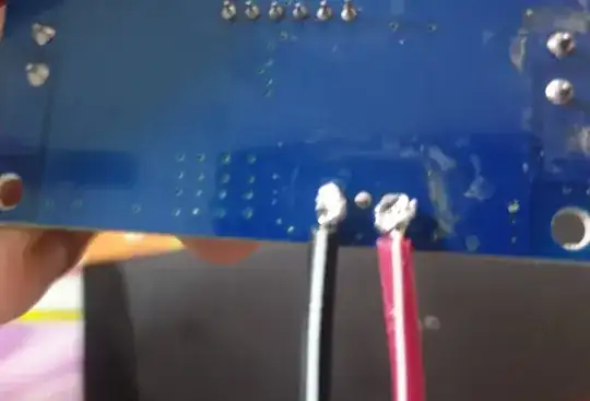

Here's the completed board. Don't mind the poor solder joints, please.

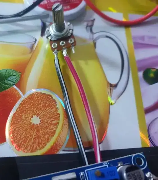

Here's the potentiometer at the top. It's 10k.
How the pot-meter is joined to the board:
Here are some images/videos of what I've done: https://i.stack.imgur.com/7COEs.jpg

  • It looks like you put your external pot in parallel to the entire onboard pot (not it's wiper). So if you lower the external pot's resistance you're just (over)loading the output. – Unimportant Jun 10 '21 at 14:05
  • @Unimportant, thanks for the help. Unfortunately, that's not it. I tried removing the potmeter and the issue still persisted. – Katylar Jun 10 '21 at 14:15
