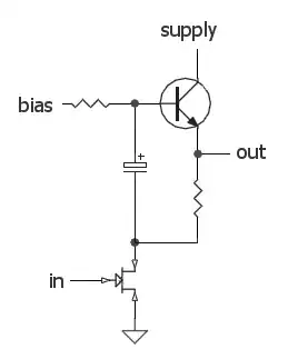

Another one that I have seen is: I don't quite understand this FET-BJT preamp circuit
And the schematic is for a pre-amp, and there are 2 versions and both add a bias.

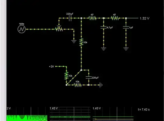

Edit/Update: Looking at the answers - using the second one looks like it will work best for my application, using something like this. Are there any other improvements I can make? Other then Stable Vref/power rails.

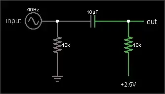

This is what you're trying to do:
simple DC biasing

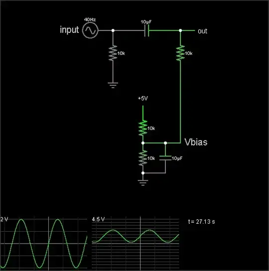

The output is the same as the input, just shifted upward by 2.5 V. The resistor on the input ensures that the input side of the capacitor is already at 0 VDC bias when an external circuit is connected, to prevent "pop" sounds (if the voltage suddenly jumped from 2.5 V to 0 V). The resistor on the output side of the AC coupling cap biases that side to the DC bias voltage. If your circuit already has a clean, low impedance DC bias voltage source, connect to that. Otherwise, you can use circuit #2 to generate the bias, like this:
Circuit showing DC biasing of an AC signal
(The simulation takes a loong time to reach the DC bias value, though. Hit the "Find DC operating point" menu entry to settle it.)
The DC bias voltage is produced by a voltage divider and capacitor to filter out power supply noise. Note that if you use the same Vbias point for multiple signals, they can crosstalk through this point. Larger bias cap reduces crosstalk. Larger coupling capacitor improves low frequency response. But make them too large and they'll take a long time to charge when you flip the power switch.
The 3rd diagram is not a biasing circuit; it's a microphone preamplifier.

    @endolith "The resistor on the input ensures that the input side of the capacitor is at 0 VDC, to prevent pops during connection." can you please explain it a little bit more for me? is this to discharge the capacitor? why it may pop? what will happen if I leave it? Sorry if the questions are silly. – Sourav Ghosh May 13 '20 at 16:38
    @SouravGhosh If that resistor weren't there, and the input was not yet connected, and you turned on the power, then both sides of the capacitor would rise at the same time until they were at Vbias=2.5 V. If you then connected a device that had an output resistance of 100 Ω, for instance, connected to ground, then the input side of the capacitor would be instantly pulled close to 0, causing the output of the capacitor to jump to 0 as well, producing a pop sound. Then the capacitor would slowly charge through the 100 Ω and 10 kΩ resistors until the input was 0 and the output was 2.5 V – endolith May 13 '20 at 19:50
    @endolith Thank you very much. Now it is quite clear. I also visited your circuit simulation, removed the input and the resistor, decreased simulation speed, and verified this behavior. At first, I was confused after reading your answer because I thought you were talking about capacitor popping (i.e, destruction of the capacitor). Now I understand that it is the 'pop' sound that we get sometimes after connecting a speaker. – Sourav Ghosh May 14 '20 at 09:49
    @SouravGhosh Ah, yes, I'll clarify – endolith May 14 '20 at 16:13

The third method is over kill for what you are wanting to do. It is designed to give higher power outputs, but since you are just reading it with an ADC there is no reason you need it.
