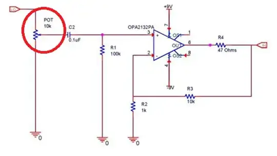

By the way, this is the circuit I am trying to control. The analog potentiometer that I want to replace is circled in red.

  • The DC component is already being removed by C2 after the analog pot. The digital pot will not withstand negative voltage like the analog pot will, so you will need to decouple it first and add an offset. – Jon Feb 23 '15 at 22:21

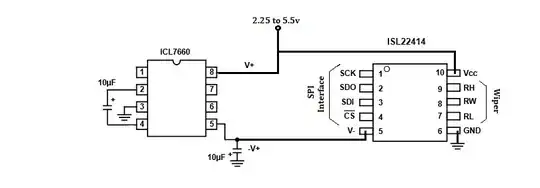

As long as your incoming signal does not exceed ±5.5v, you can use a digital pot like the ISL22414 that tolerates negative voltages. To drive that, you will need a negative supply, but that can be provided easily by a low-cost voltage converter like the ICL7660 (which I have used in a product, and works fine).
Something like this:
If your signal does exceed ±5.5v, you could add a voltage divider in front of the pot.

  • Generating a negative rail for the digipot, when the signal is immediately AC coupled afterwards, seems a bit pointless. – Nick Johnson Feb 24 '15 at 11:10
  • @NickJohnson I was trying to fit the digital pot in as an exact replacement for the pot shown in his schematic without changing anything else. – tcrosley Feb 24 '15 at 13:50

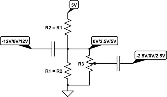

This is not 100.00% complete:
schematic
Re: comments
The YouTube lady cut this out of a larger circuit to demonstrate the potentiometer's function, not necessarily how to use them correctly for audio applications. We aren't shown the input or output stages. The pot should be grounded at or below the lowest voltage expected on the input. As per the comments, her diagram also shows input and output swapped. Her setup was "good-enough" to demonstrate the pot doing work.
Take all internet advice with a grain of datasheet-salt.
See figures 13 and 14 in this selection guide.
Figure 13 is referenced to 0V and is decoupled after the pot.
Figure 14 is referenced to -15V and is decoupled immediately.
