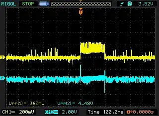

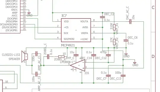

See attached for screenshot of the oscilloscope, with the probe being on the MCP4921 output (after the AC coupling cap). Also attached is the schematic. The schematic does not show the two possible solutions which I mentioned above. The purpose of the V_REF Resistors is to make a voltage divider that will give 0.25V at the V_Ref of the MCP4921. This was done so that the default gain of the amplifier, 20, will produce a 5Vp-p signal at the speaker.
Oscilloscope Output, Yellow is output of the MCP4921, past the AC Coupling cap, and Blue is at the speaker
EAGLE Schematic for Audio Module

    Just curious, what's the purpose of DEC_C12 on the negative input of the LM386N? The negative input is already shorted to ground, so the cap seems to be useless – calcium3000 Nov 13 '17 at 03:43
  • I built my audio circuit according to this link: http://www.circuitbasics.com/build-a-great-sounding-audio-amplifier-with-bass-boost-from-the-lm386/. There, the person says that the 470pF cap is to filter any noise from radio interference on the audio input line. Now that I am thinking about it, would my circuit need this since I'm getting input straight from a DAC instead? Also, I noticed he might have made a mistake, since he said between ground and the positive input, but in his schematic its between ground and the negative input, so it would be shorted, like you are indicating? – user2608147 Nov 13 '17 at 16:05
  • Yes, if your audio source (DAC) is so close and your traces are nice and short I'd think you'd be able to omit it. But just in case, I'd add it on your PCB and make it a do not place (DNP) in case you'd want to add one later. And yes, the schematic is wrong -- the cap should be connected to the positive input pin to ground. – calcium3000 Nov 13 '17 at 19:02

  • I tried your solution, by just doing an if...else statement, where if a certain amount of time elapsed, a sound would play, else I am just constantly inputting 0x80 to the DAC like you suggested. Although the zero of the "off" waveform is now in line with the "on" waveform, I still get the clicks in the beginning and end when the sound plays. – user2608147 Nov 13 '17 at 21:38
