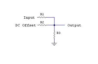

https://electronics.stackexchange.com/a/14416/254310 - they attenuate the signal significantly, e.g. in the simplest form:
https://forum.allaboutcircuits.com/threads/add-and-remove-dc-bias-from-a-signal.72479/#post-506668
In the first case, naively removing the cap just shorts the input to the output i.e. no biasing is applied. I ran SPICE simulations which (I think) confirmed what I'm saying, although I never used SPICE before so I may well have got some or all of it wrong.
