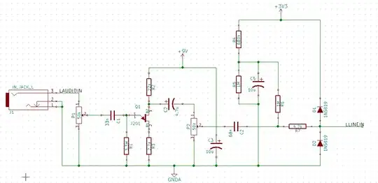

Edit/update From the replies below it is now clear that a DC offset on analog inputs is not necessary, but this gave rise to another query. Initially, because of previous experience with other ADC's, I approached the input design under the notion that it was.
The inputs were to take a signal from an electric guitar, amplify it and then add an offset (redundant now). This is shown in the schematic below.Analog Input
The preamp is of the common source self biased topology based on the j201 JFET. The potentiometer P2's purpose is to attenuate some of the gain so that the AC swing could be limited between -1.65v and +1.65v. The next stage is a voltage divider that adds dc offset to bring AC swing to 0 - 3.3v This was one of the methods mentioned in another question shown on the page DC biasing audio signal
Before this revision, R4, R5 and R6 were all 100k values, which in theory is perfectly fine. What I found was that when I connected R6 to just after C2, to add the bias, most of the gain from the preamp stage was attenuated. This was because adding the DC offset stage loaded down the lower half of the voltage divider created by P2. The solution was to change the values of the resistors so that they would be much larger than the potentiometer. This fixed the gain issue, but I then found the dc offset was slightly off. I then had to decrease R4 to get the clean 1.65v I needed.
The reason I explain all of this is because I now wonder if removing my dc offset stage and connecting it to the codec LINEIN will have a similar effect. If so, I wouldn't be able to adjust the internal resistor values of the codec to compensate.
Please let me know of any misconceptions you think I may have.
