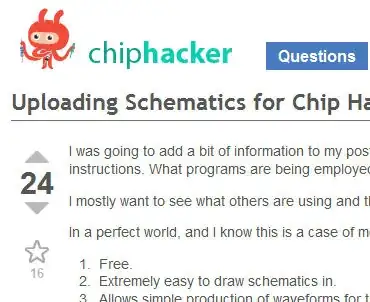

I was going to add a bit of information to my post on a previous day using schematics and some instructions. What programs are being employed for this purpose?
I mostly want to see what others are using and that I can easily use to give descriptive schematics.
In a perfect world, and I know this is a case of me wishing, it would be:
  1. Free.
  2. Extremely easy to draw schematics in.
  3. Allows simple production of waveforms for the inputs/outputs.

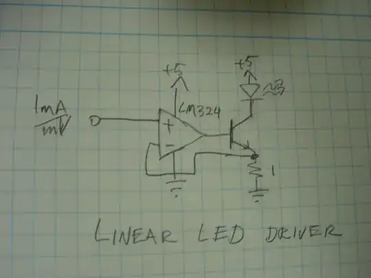

My favorite schematic capture tool is a pencil on green-gridded engineering paper, and a camera.
Once I have the schematic how I like it, it goes into gschem.
But for just sketching up circuits, paper is the way to go.
linear drivers rock
markrages
  • 20,015
  • 60
  • 97
    I keep a field notebook around for that. It comes gridded, with ruled pages opposite for notes. It's also water-resistant, so if it comes with you everywhere and you live in a rainy climate there's an extra level of protection. – Lou Dec 16 '09 at 16:52
  • I have design journals around that look the same, but I doubt my boss would enjoy me jotting down things for chiphacker in them. – Kortuk Dec 16 '09 at 18:13
    Point taken on the picture, I wish I always had paper with me. I also wish my handwriting was readable. – Kortuk Dec 16 '09 at 23:03
    This is what I do at work, too. I just scribble something down, take a picture of it, and email it to the factory. :) – endolith Dec 17 '09 at 21:31
    I use a scanner (better quality for line drawings than camera) + paper/pencil. Looks great! – Jason S Dec 20 '09 at 15:18
  • That takes me back - similar to all those old Radio Shack books by Forrest Mims III... –  May 06 '10 at 12:02
  • That looks stunningly like my writing and drawing style. Are you OK :-) – Russell McMahon Jan 16 '12 at 18:23
  • And now with the convenience of Google Photos and modern smartphones, once you take a picture it is instantly loaded up online on your google photos account at http://www.photos.google.com. Makes saving it on the computer or inserting into a document sooo much easier. – Gabriel Staples Jan 15 '17 at 23:51
  • Is this DaveCad? – Mike Nov 17 '17 at 18:31
  • Green-gridded engineering paper appears to be difficult to purchase in the UK, the nearest thing is blue graph paper which is very common: https://static.rapidonline.com/catalogueimages/product/06/00/s06-0077p01wl.jpg – Nick Bolton Jan 26 '22 at 20:04

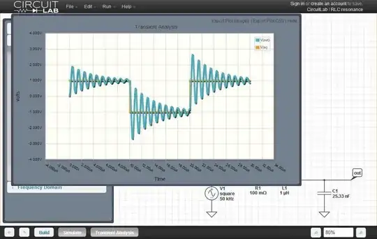

And now you can do that inside a reasonably modern browser with CircuitLab.
The community version, which is free, is somewhat limited on its library of components, but the simulator running in the browser is a testament to the power of current JavaScript engines.
Update Jan 2015: CircuitLab is not free anymore; there's only a time-limited demo without a save feature. There are commercial and non-commercial plans available. For students whose university has an academical license, use is free of charge. See all plans. The embedded CircuitLab here on EE.SE is still available free of charge.
This is an example screenshot of the Circuitlab design environment:
Enter image description here

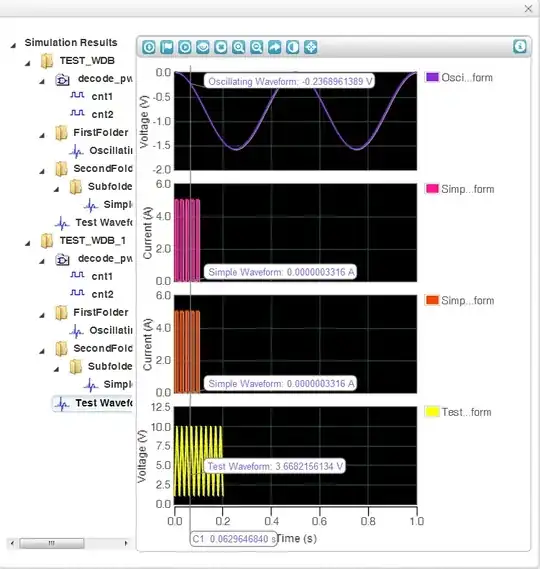

This is an example screenshot of the Circuitlab simulation environment:

    CircuitLab is now embedded into Electronics Stack Exchange! http://meta.electronics.stackexchange.com/questions/963/embedding-a-schematic-editor – weiy Feb 27 '13 at 19:40
    That simulation plot sure is ugly. – endolith May 14 '14 at 17:49
    (CircuitLab co-founder here.) Fortunately we've made the simulation plots much nicer looking since then: see https://www.circuitlab.com/editor/wt3nym/ to try this RLC resonance example. We do have partnerships with many universities now, making it free for their students and faculty. And we'd appreciate other feedback from the EE.SE community! – compumike Jan 18 '21 at 02:38

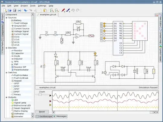

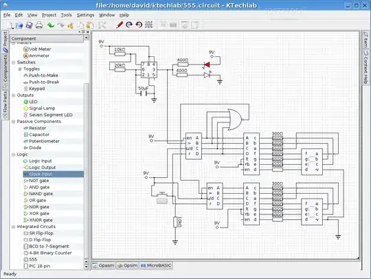

Another option is KTechlab. I suspect most people have never heard of it, but it's a free electronics simulation program that lets you do simple circuits. Schematics are easy to draw and it produces waveforms easily. I find it more intuitive and quick than a SPICE simulator, but of course it's not as powerful. It's more a system for thinking about idealized circuits, while SPICE is more a system for modeling real-life circuits, along with all their flaws and frailties. It's Linux-only, but you can run it in Virtualbox or something.
alt text alt text

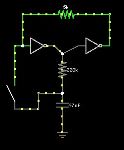

This Java circuit simulator is pretty easy to draw schematics in, and it has a way to export them as plain text:
$ 1 5.0E-6 0.9891409633455756 46 5.0 50
I 240 256 304 256 0 0.5
I 352 256 416 256 0 0.5
w 416 256 416 192 0
w 240 192 240 256 0
r 320 272 320 336 0 220000.0
c 320 352 320 400 0 4.7000000000000004E-8 1.4535908873993098
g 320 416 320 432 0
s 224 384 224 320 0 1 true
w 240 256 224 256 0
w 224 256 224 320 0
w 272 384 224 384 0
w 320 352 320 336 0
w 320 400 320 416 0
w 272 384 272 352 0
w 272 352 320 352 0
w 304 256 320 272 0
w 352 256 320 272 0
r 240 192 416 192 0 5000.0
o 1 64 0 35 5.0 0.0015625 0 -1
The above code will produce this circuit:
two-inverter momentary toggle
Maybe there's a way to integrate it into a site, so that users can draw a circuit, paste the above code into the answer box, surround it with special tags, and it will create a pop-up applet?
Even better, a schematic image could be generated from the code, which, when clicked on, opens a simulation applet of that schematic.
Maybe talk to the author about something like this? He has the applet zipped up for you to use on your own computer, but I don't know about distributing it on other websites.
Update: I talked to the author, and he implemented URL data within hours of me proposing it. There is now an "Export Link" menu option that generates links like this, without requiring a directory or hashtable on the server or anything. You can use the same URL to display the same circuit while using the java file on your own computer:
This should display the above circuit
And he pointed out the licensing agreement, which I think permits us to modify it and use it on here to embed schematics, like this.
You have permission to modify the applets and/or copy the applets onto your own web site as long as you credit me (Paul Falstad) and provide a link to my page
This 4000 character URL should show a 7-segment decoder

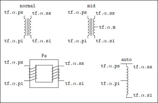

TeX can be used to generate publication-quality schematics. Here are some examples.
CircuiTikz is a set of LaTeX macros designed to make it easy to draw electrical networks in scientific publications. It provides a convenient syntax based on to-paths to place the various components.

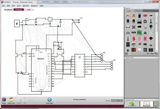

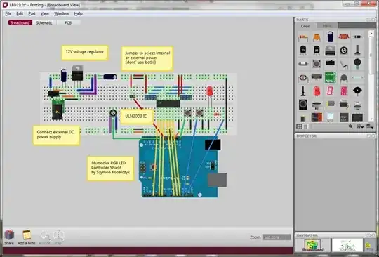

    I know how to do schematics/simulations/layouts and I am not finding this to be the issue. The problem I have had is having one that is very fast to use for when I want to give more detailed answers on chiphacker. I have some time for chiphacker, but not enough to be doing full simulations for questions regularly. – Kortuk Dec 16 '09 at 06:43
    The simple/intuitive nature of Fritzing will lend itself to your goals I think. I encourage you to take a look. – MrEvil Dec 16 '09 at 10:24
  • Fritzing seems to have a lot of community potential. If it takes off in the same way as the Arduino project, it could be really great. Right now, it's lacking some essential components, but seems to be moving forward. – Greg Jun 16 '10 at 14:27
  • This looks interesting. – antony.trupe Apr 20 '11 at 01:58
  • I use it for all my PCB design so useful. – Anonymous Penguin Oct 29 '13 at 21:38

There's also this web-based thing, meant to have screenshots taken of it:
http://www.qsl.net/wd9eyb/klunky/framed.html
But could it be modified to generate code that could be copied and pasted into this site? Something that generates a single image would be preferable, of course.
 R
Rnpn
 R
There's a real need for a quick web-based schematic drawing tool, not just here, but everywhere. I would code it if I knew how, but my skills are weak. Could we somehow commission someone at Stack Overflow to write something in exchange for reputation points? In exchange for money? Kickstarter? A simple JavaScript editor could allow for blocks to be put next to each other, like this Klunky editor, then it could generate a URL with a bunch of gibberish at the end, which then causes the server to generate a single PNG, for instance.
The image could be linked directly from forums or copied to Imgur automatically by the Stack Exchange software. The URL of the image could be plugged back into the editor to allow modifications, etc.
The text labels in Klunky could use some work, too.
Or if Stack Exchange accepted data: URLs, it could generate an image that could be copied and pasted into the URL box without requiring a server at all. :)
Or SVG. Or Flash. Or something. But I think a simple block-based editor would be sufficient for the vast majority of online schematic examples, rather than a full-fledged schematic capture program that allows you to draw wires manually and move components one pixel at a time and change all their parameters.
Here's an HTML 5 image editor that generates images as data: URLs, for instance:
Data URLs can be converted into tinyurls!
http://preview.tinyurl.com/smallreddot

Some that I recommend for small projects and prototyping is Fritzing.
They are very good to convert the schematic to a prototype board. And very easy to use.
And the best, it's free!
enter image description hereenter image description here

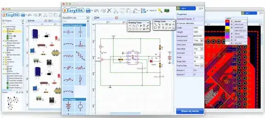

If you don't mind an online tool, may I sugest easyEDA:
Also upverter and 123d circuits are online viable options.
Rui Lima
  • 689
  • 23
  • used this for the first time recently, really easy to use and the 3D simulation is 1-click and looks really good. also direct integration with JLCPCB to buy the board. – nick fox Jan 21 '23 at 15:00

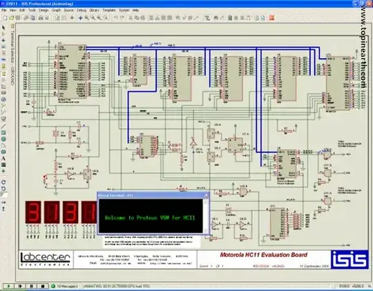

  1. Proteus:
This is one of my all-time top favorites, though it comes at quite a price. This is generally better for professional applications that require extensive tools, and applications where software price isn't an issue. Like Multisim, Proteus combines Schematic/PCB design with simulation, making it a very useful tool in the workplace. Link: http://www.labcenter.com/index.cfm Image: Proteus 8.1

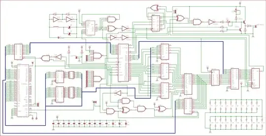

gEDA is a free and open source tool. The gEDA package includes a schematic editor, PCB layout editor, Gerber viewer, bill of materials (BOM) generation, etc.
It also has a huge symbol library.
Check gEDA/PCB Stuff for a bunch of projects designed using gEDA.
A video game made using gEDA:

ViaDesigner is free, easy-to-use schematic capture and simulation that you use in your browser. Public designs are free and you start paying if you want private, team or implementation features. ViaDesigner lets you combine analog, digital and mixed-signal circuits in a unified simulation environment that supports VHDL-AMS, SPICE, VHDL and Verilog design entry formats.
VHDL-AMS sounds pretty complicated but you don't need to learn how to write VHDL-AMS or SPICE models to use ViaDesigner. Instead, ViaDesigner comes with a set of high-level design wizards that generate useful mixed-signal circuits like: gain stages, filters, analog to digital converters, DAC, linear & switching regulators, etc. Example wizards can be found here: ViaDesigner Wizards.
Here's some screenshots of the ViaDesigner schematic & simulation environment:
ViaDesigner Schematic Screenshot
ViaDesigner Simulation Waveform Viewer
Ultimately, ViaDesigner.com is focused on letting you design your own mixed-signal custom chips easily and cost-effectively. ViaDesigner will soon have a complete IC design flow in the cloud. This implementation design flow isn't free but the goal is to enable custom mixed-signal IC design, verification and fabrication for about $10,000. That's a lot of money but typical IC design flows can be anywhere from $100,000 to $1-million.
Yes, I work at ViaDesigner & these are my biased opinions about the ViaDesigner.com and the ViaDesigner software but still I'm pretty excited about what we are putting together.

I use FastStone capture to post screen shots.
Here are the steps:
  1. Ctrl + PrtScn
  2. Drag the area I want to capture
  3. It pops up the image
  4. I click on ftp. It knows my domain and where to put it. It makes up a name based on the date. It copies the URL to the clipboard
  5. I Ctrl + V the URL to the insert picture icon
That's it. You still have to have a schematic on your computer, but this addresses a large part of your question.
Here's an example:
Alt text
mmccoo
  • 951
  • 15
  • 23
  • clearly a quick way to get it done when you are setup. I use multiple computers, many of them in a computer lab. I also like a solution I can quickly have working without installing software. If i set something up on one computer I think this may be the ticket. – Kortuk Jul 17 '10 at 17:11
  • I usually use alt-printscreen + mspaint + imageshack.us. Same effect as above, maybe slightly more steps to follow, but works on every version of windows without installing anything. – davr Aug 23 '10 at 18:19
    Stack Exchange now has a network-wide pro account with imgur. Clicking the button above your answer will allow you to upload an image from your computer. With this host, we won't loose images when other sites go down/out of business/expire. Please don't host screenshots on your own site (or other image hosts, or anonymously on imgur). – Kevin Vermeer Oct 25 '10 at 15:36
  • @reemrevnivek, now when you link a picture from your own site it automatically takes it and uploads it with their account. – Kortuk Dec 22 '10 at 18:12
    @mmccoo Do you still have a screen shot that you can post for us? Your current one doesn't make a whole lot of sense. – Kellenjb Jan 27 '12 at 18:15
  • @Kortuk > " I use multiple computers, many of them in a computer lab." -- I can't help but mention Synergy. Ever used it? – Nick Bolton Nov 06 '22 at 11:30
