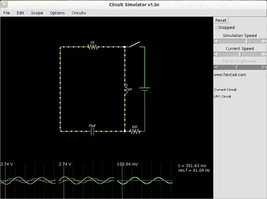

As others mentioned you have to draw your schematic but Falstad's Circut Simulator is visually close to what you want. Although It's not capable as other simulation softwares it still contains most of the basic components which may help you understand working principles of simple circuits.
It shows you current current on all nodes and by right clicking to a node and selecting "View in Scope" you can see voltage change on this node.
Also being java it's cross-platform and can work from web-browser.

  • This is iCircuit for Windows edition? I have used iCircuit in iPad so far, it is very cool. – hhh Apr 22 '13 at 02:10
    No. Please read icircuit homepage. "iCircuit wouldn't be possible if it weren't for the pioneering work and generosity of Mr. Paul Falstad." – HeyYO Apr 22 '13 at 02:28
  • iCircuit is the Falstad simulator for iOS, not the other way. – Connor Wolf Apr 22 '13 at 03:19
