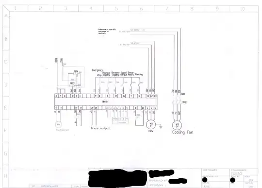

Is anyone aware of a good linux program for drawing automation schematics? Not PCB design, circuit simulation and fine electronics. Industrial automation.
Example: Example schematic
I looked at a couple of different EDA applications, but did not find any functionality for multiple sheets in a single schematic. I will also need cross-reference symbols to handle nets/symbols that go across multiple sheets.
Perhaps someone knows about an EDA application with multiple sheets and good scripting capabilities to create the cross-reference system?
Solution: I ended up using gschem with some custom scripts for cross-references and titleblock stuff. They can be found here.
