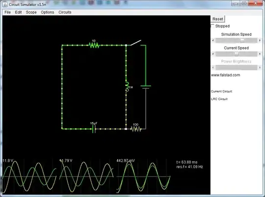

I also like Faltad's Java applet as you can choose from many small scale projects and export them as a http link Wait a few seconds.. Right mouse can edit any part and add scope traces then stack them, add passive active parts etc. then add wire jumpers, move parts. It is very intuitive, quick and easy.
Start with the built-in examples here Index enter image description here
