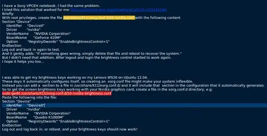

I have a Sony VPCEH notebook, I had the same problem. I tried this solution that worked for me: http://ubuntuforums.org/showthread.php?t=2221452#6
Briefly: With root privileges, create the file /usr/share/X11/xorg.conf.d/20-nvidia.conf with the following content
Section "Device"
    Identifier     "Device0"
    Driver         "nvidia"
    VendorName     "NVIDIA Corporation"
    BoardName      "GeForce 410M"
    Option         "RegistryDwords" "EnableBrightnessControl=1"
EndSection
Log out and back in again to test. The link above also states: "If something goes wrong, simply delete that file and reboot to recover the system", but I didn't need that addition.
After logout and login the brightness control started to work again. I hope it helps you too...
or this one after works with ubuntu 16.04 under my laptop sony VPCEJ2C5E but with nvidia 378.13 i don't have use for the moment the 390.25 drivers.
I was able to get my brightness keys working on my Lenovo W530 on Ubuntu 12.04. These days X automatically configures itself, so creating an xorg.conf file might make your system inflexible. Instead you can add a section to a file in /usr/share/X11/xorg.conf.d/ and X will include that section in the configuration that it automatically generates. So to get the screen brightness keys working with your Nvidia graphics card, create a file in the xorg.conf.d directory, e.g: sudo gedit /usr/share/X11/xorg.conf.d/10-nvidia-brightness.conf Paste the following into the file:
Section "Device"
    Driver         "nvidia"
    BoardName      "Quadro K1000M"
EndSection
Log out and log back in, or reboot, and your brightness keys should now work!
