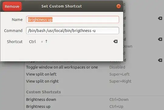

I have Ubuntu 17.10 installed on a MSI GT72VR laptop with a single nVidia GT1060 graphics card, grub2 as a bootand Unity as a desktop. I can't change the brightness in any way. Bright always is 100%. I have tried the following options that have not worked.
THINGS THAT HAVE NOT WORKED [UPDATED OUTPUTS AT 30TH APRIL Of 2018]
  • Fn + Bright Up or Bright Down buttons shows icon inline at screen, but brigthnes can't change.
  • Brightness slider at top bar doesn't work.
  • GRUB_CMDLINE_LINUX_DEFAULT="quiet splashacpi_backlight=vendor"
  • GRUB_CMDLINE_LINUX_DEFAULT="quiet splashacpi_backlight=native"
  • GRUB_CMDLINE_LINUX_DEFAULT="quiet splashacpi_backlight=video"
  • GRUB_CMDLINE_LINUX_DEFAULT="quiet splashacpi_backlight=none"
  • Utility xbacklight shows "No outputs have backlight property"
  • Using nouveau X.Org display driver from software update
  • NVIDIA binary driver version 396
  • NVIDIA binary driver version 390
  • Changing file brigtness on /sys/class/backlight/acpi_video0/ and doesn't work
  • Using latest Kernel upstream mainline version v4.15.7 (February 28)
  • Live USB Ubuntu
  • Using a file on /etc/X11/xorg.conf with Section "Device" ...
  • Log session as "Ubuntu on XOrg" and disable Wayland

Thanks everybody
I created a temporally bash script to adjust brightness level. Then I create 2 sortcuts at keyboard mapping settings to set up CTRL + Brightness UP or CTRL + Brightness Down with this script:
#!/bin/bash
# Step brightness value
STEP=2
# Max brightness value (defult 100)
MAX=100
# Min brightness value (defult 0)
MIN=0
COMMAND=$(xrandr --verbose | grep -i brightness | cut -f2 -d':' | tr -d "[:space:]")
ACTUAL=$(bc -l <<< $COMMAND*100 | cut -f1 -d'.')
while getopts ": u d" input
do
    case $input in
    u)  if [ $ACTUAL -lt $MAX ];then
                TOTAL=$(bc -l <<< $(($ACTUAL+$STEP))/100)
                $(xrandr --output DP-0 --brightness $TOTAL)
        fi;;
    d)  if [ $ACTUAL -gt $MIN ];then
                TOTAL=$(bc -l <<< $(($ACTUAL-$STEP))/100)
        fi;;
    ?)  printf "Usage: brightness [OPTION]\n"
        printf "Increase or decrease birghtness on Ubuntu Xorg.\n"
        printf "WAYLAND MUST BE DISABLED\n\n"
        printf "  -u\t Increases brightness\n"
        printf "  -d\t Decreases brightness\n"
        exit 2;;
    esac
done
And in set custom shortcut I added this Set Custom Shortcut
