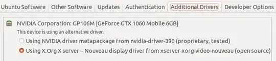

The problem is that I can't adjust the brightness of my screen. Always is 100%. I've got Ubuntu 18.04 clean install and nouveau drivers (Xorg.org) enter image description here

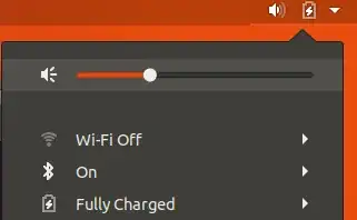

There aren't brightness slider at the top of bar:
brightness slider
