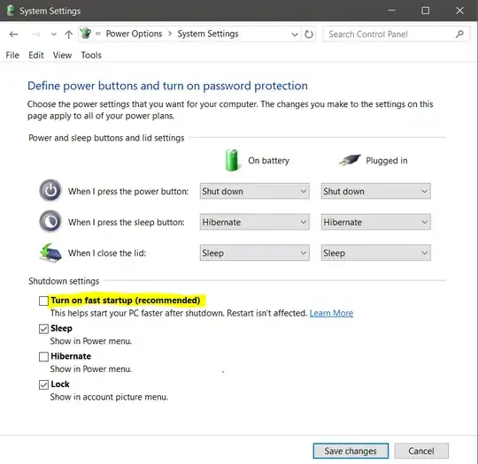

The Windows 10 update reseted it to the default fast startup which is a form of hibernation.
You need to disable this feature (again, probably) in Windows and then shutdown, not reboot. Once done properly you'll be able to access the data partition normally with read/write permissions.
The location of Fast Boot option in windows10
