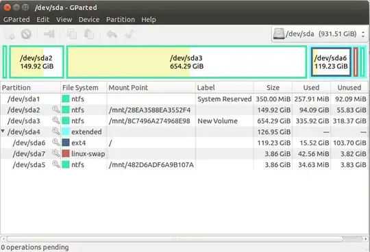

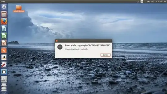

How to fix The destination is read-only error on HDD partition with Windows 8.1 dual boot?
Error while copying to ntfs partition

For me the solution was quite simple:
killall nautilus
First I tried with gpart and disk utilities to erase the partition but the problem still there, I saw answers about mount by hand or about win solutions but it doesn't make sense for me because my usb was created with an image of ubuntu with dd!. At the end, it seems to be a nautilus's bug. Just restart your PC or kill your nautilus and the problem will gone.
