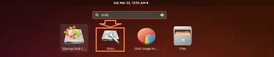

Open up bash and Search for Disks as shown below:

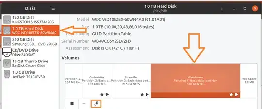

Click Disks to open up the Software and you select the NTFS partitioned disk of interest. Suppose your target disk is 1 TB having three partitions all with NTFS filesystems.
Assume that it is Warehouse Partition to be made as read-write.
Click the cog icon shown in small redbox and soon after you will face a drop-down menu. Click Edit Mount Options... which will take you to another window where you should enter ,rw as shown in the below screenshot:
Press OK and exit.

512 BG Disk window Mount Options sub-window
