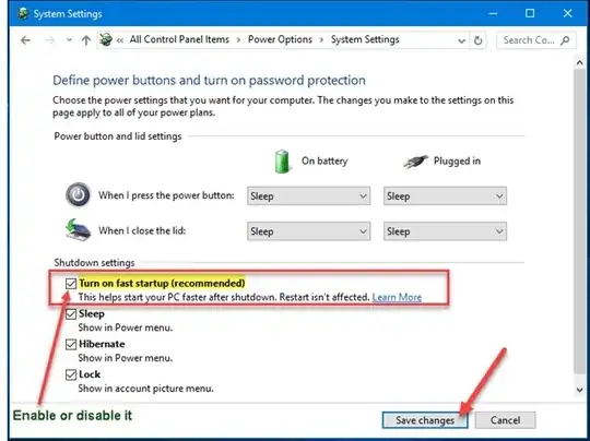

Windows has a 'fast startup' feature that shutdow windows with a kind of hibernate but not full shutdown
to get your windows drives writable, you must full shutdown windows
hold Shift key while pressing the shutdown button of windows
you may disable the 'fast startup' feature from windows power control panel enter image description here
