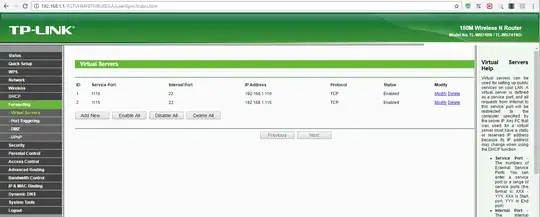

Here you are, an example for port forwarding on TP-LINK home router:

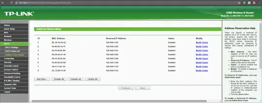

It is a good idea to set up static IP addresses for the devices in your local network. One of the ways to do that is through address reservation page in the router's setting:
address reservation
