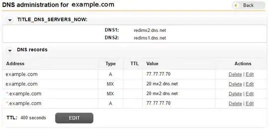

You can reach this IP address 2.186.116.46 (if my computer is online). I want to assign a domain to it so I wonder how is that possible when I have no DNS? I do own my domain which is ".com". My IP is static.
Thanks
wjandrea
  • 14,504
18
1. You need to acquire a domain name (or maybe just FQDN) from some DNS provider.
2. Once you have registered the domain name, you will gain access to an administrative panel (like this one shown below), where you will be able (via A records), to redirect the domain name (and all *. or certain sub domains / FQDNs) to your server's IP address.
  • Please note that the provider's administrative panel shall looks different, and the provider will give you exact instructions how to use it.
  • Sometimes the redirection can take up-to 24 hours. You can check if it's successful by the command whois example.com.
  • If the server is behind NAT, you must setup port forwarding.
