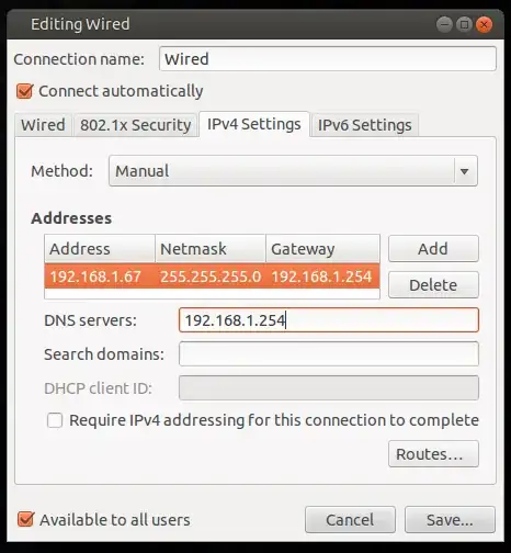

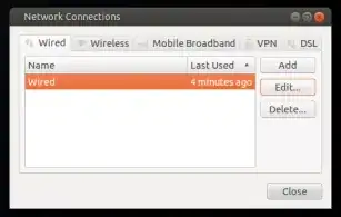

To give static ip address graphically
1.Go to network connections
2.Then edit the connections in the wired settings
3.Add the ip address for the system
Here are the images below
Network Connections
Network-connections![
