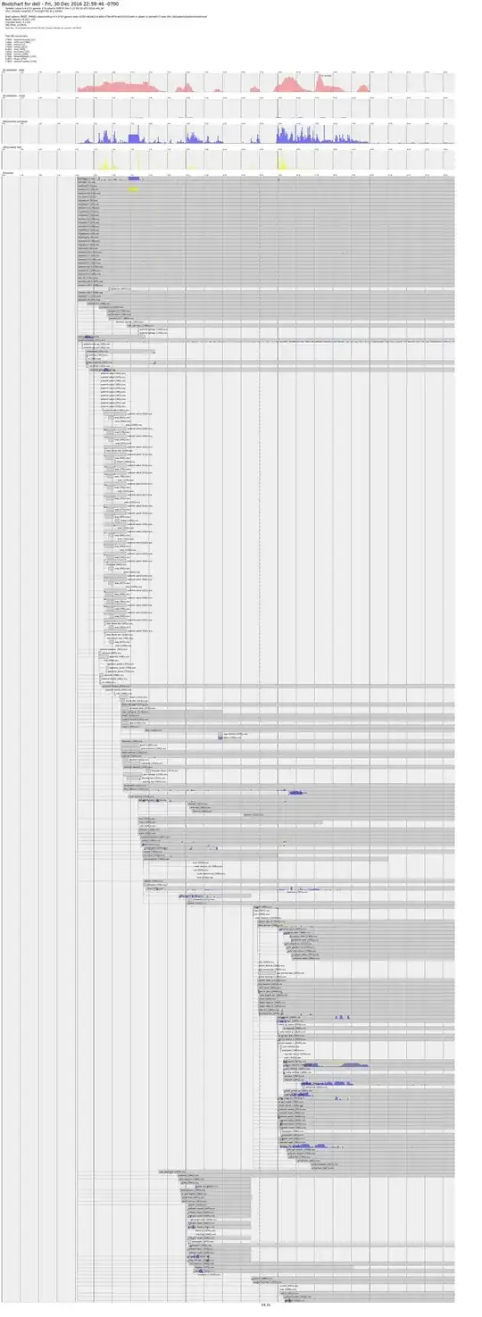

EDIT 1: - systemd Boot Chart
As per comments below I've included the systemd-bootchart which is generated by modifying grub kernel parameters with:
GRUB_CMDLINE_LINUX_DEFAULT="splash vt.handoff=7 kaslr init=/lib/systemd/systemd-bootchart"
The boot chart is saved to: /run/log/bootchart-20161224-1801.svg. I had to use gimp to open and export it in .jpg format at 75% quality to make it fit in Ask Ubuntu's 2.1 MB limit. The exported file is shown below:
systemd bootchart
Notice the 9 second delay at the begining. The "normal" delay of 7 seconds for "Loading initial ramdisk ..." message in grub is now about 10 seconds. The extra time likely attributable to systemd-bootchart overhead.

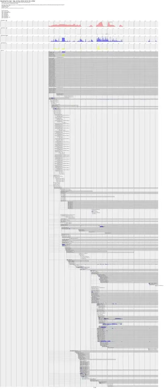

Edit 3 - Speed improved.
After implementing the Q&A answer I wrote (How can I set up a password for the 'rm' command?) where a wrapper script password protects the rm command, boot speed has doubled.
Here's the new graph:
bootchart dec 30
