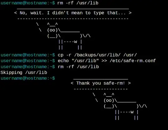

One method would be to use safe-rm. This will ONLY adress the usage of "rm" and preventing specific versions of "rm" to be run. That includes removing your root system but can also be used to prevent removing of system related directories like "/usr/" or "/var/". From the link:
Reventing the accidental deletion of important files
Safe-rm is a safety tool intended to prevent the accidental deletion of important files by replacing /bin/rm with a wrapper, which checks the given arguments against a configurable blacklist of files and directories that should never be removed.
Users who attempt to delete one of these protected files or directories will not be able to do so and will be shown a warning message instead:
$ rm -rf /usr
Skipping /usr
(Protected paths can be set both at the site and user levels.)
Recovering important files you deleted by mistake can be quite hard. Protect yourself today by installing safe-rm and reduce the likelihood that you will need to contact a data recovery service!
