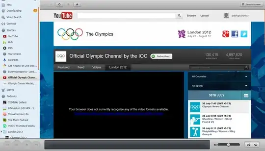

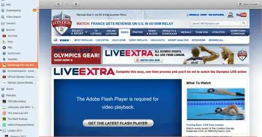

I wanted to watch the Olympics, so I installed Miro 5.0.2 (49960df1) on Ubuntu 12.04 32-bit. After downloading the Olympics podcasts, I tried to watch the live streams but I was greeted with these messages despite the fact that I already had Adobe Flash 11.2 installed on my system:
So I tried installing the one from Adobe's website, too. The same video runs without any problem in the browser, but not in Miro. I get the same message every time.
I'd really appreciate any help in solving this problem so that I could watch the live streams on Miro itself.
I'd suggest you try this from user79939 at How can I watch the NBC Olympics 2012 (USA)?. If it works the basic problem is that the streams are protected content.
As per this post on the Adobe website:
Step One: Install HAL
sudo apt-get install hal
Step Two: Quit your web browser
Step Three: Clean out the Adobe Flash folder:
cd ~/.adobe/Flash_Player rm -rf NativeCache AssetCache APSPrivateData2
This process worked for me. In my case, I'd been able to go to nbcolympics.com and click the log to begin the verification process, but never given the chance to enter my Comcast credentials. Doing the steps above fixed everything.
