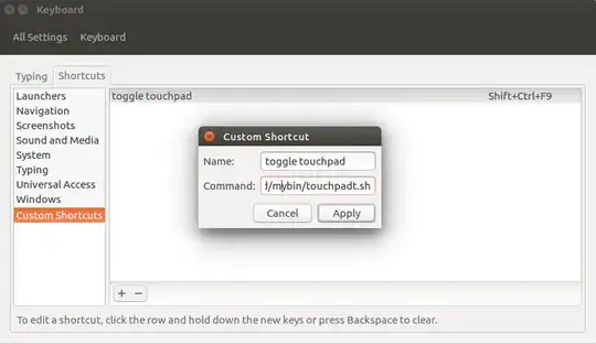

I'm setting Ctrl+Shift+F9 for toggle touchpad enable and disable like this:
Update: You may need to make your script to executable with command chmod +x filename or input /bin/bash /filepath to Command field of Custom shortcut window.
