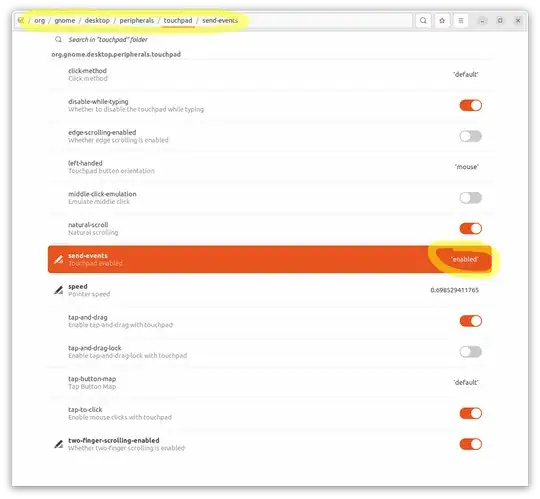

The way I figured this stuff out is by digging around in the dconf-editor settings to explore what settings and options existed.
Install it with:
sudo apt update
sudo apt install dconf-editor
Here is a screenshot of the org.gnome.desktop.peripherals.touchpad settings page in it:

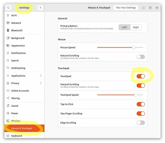

Note also that you can open your regular Ubuntu "Settings" --> "Mouse & Touchpad" --> and view the "Touchpad" enable toggle turn on and off as you manually run the enable/disable command-line commands above:

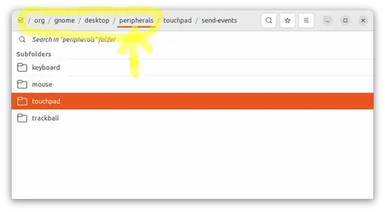

To figure out how to disable other external devices, such as touchscreens, trackballs, tracksticks, etc, go up a couple levels to the org.gnome.desktop.peripherals section of the dconf-editor, and drill down to explore their settings from there:
