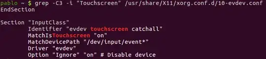

The xinput solution did not work for me. I instead followed the instructions in this thread. This will disable it at boot time.
  1. Edit /usr/share/X11/xorg.conf.d/10-evdev.conf
  2. Add Option "Ignore" "on" to the end of the section with the touchscreen identifier
  3. Reboot

Edit file the file with
sudo nano /usr/share/X11/xorg.conf.d/10-evdev.conf
Change MatchIsTouchscreen from "on" to "off" in the Touchscreen section so it looks like this:
Section "InputClass"
    Identifier "evdev touchscreen catchall"
    MatchIsTouchscreen "off"
    MatchDevicePath "/dev/input/event*"
    Driver "evdev"
    EndSection
Save, Name and Exit
Touchscreen is disabled and no longer detected in xinput list.
