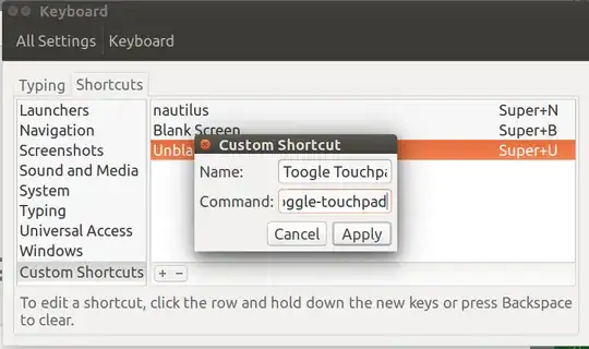

Assign toggle-touchpad script to keyboard shortcut
Open up System SettingsKeyboardShortcutsCustom Shortcuts+
This screen appears:
toggle-touchpad
Fill in the Custom Shortcut fields like this:
  • Name = Toggle Touchpad
  • Command = /home/USER/bin/toggle-touchpad
Click Apply button to save.
The new entry appears with status Disabled. Right click on Disabled and use Super+Z (or any other unused shortcut combination). I wanted to use Super+T but that is already assigned to Nautilus Trashcan.
