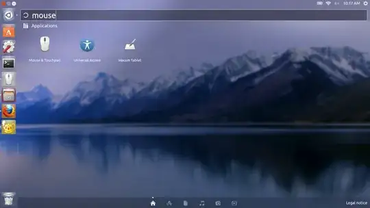

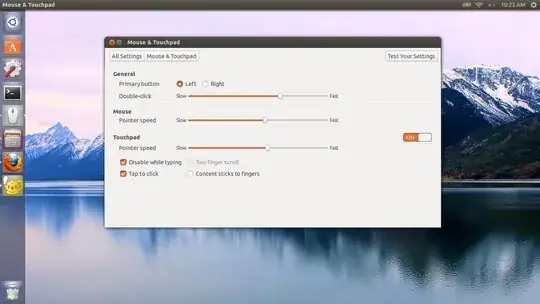

  1. Search for mouse
  2. Click on Mouse and Touchpad
  3. Click off/on button to the right of touchpad settings.
step one

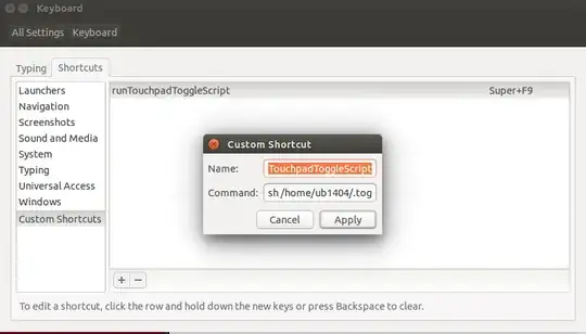

Save the above script file as .toggleTouchPad.sh at where you want.

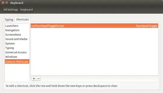

3. Keyboard shortcut for running the script
And last step is adding keyboard shortcut to run the script file.
So just write sh /PATH/TO/SCRIPT in the Command of your shortcut window .
4. Try the shortcut
Press the shortcut and check if touchpad is toggled.
It worked at ASUS A556UA Laptop and Ubuntu14.04 x64 installed.
Thing to be improved.
  • assigning Touchpad toggle key to the above custom shortcut would not work
  • it just shows touch pad icon on the right-top of the screen
  • so I had to assign another key(super+F9) rather than Touchpad toggle(fn+F9) key.
please suggest a way to assign Touchpad toggle key to a custom shortcut for complete solution

I created a script before on another question: https://askubuntu.com/a/874865/433961
It finds and toggles TouchPad device. You can configure a custom shortcut to it in system settings.
#!/bin/bash
read TPdevice <<< $( xinput | sed -nre '/TouchPad|Touchpad/s/.id=([0-9]).*/\1/p' ) state=$( xinput list-props "$TPdevice" | grep "Device Enabled" | grep -o "[01]$" )
if [ "$state" -eq '1' ];then xinput --disable "$TPdevice" && notify-send -i emblem-nowrite "Touchpad" "Disabled" else xinput --enable "$TPdevice" && notify-send -i input-touchpad "Touchpad" "Enabled" fi
I'm setting Ctrl+Shift+F9 for toggle touchpad enable and disable like this:
Update: You may need to make your script to executable with command chmod +x filename or input /bin/bash /filepath to Command field of Custom shortcut window.

From the menu on the top-right go to system-settings->keyboard->shortcuts->custom-shortcuts.
Create a new shortcut and put as name whatever you want. Put as command /home<username>;/myscripts/toggle_touchpad.sh where "username" is your username
Assign whatever keyboard shortcut you want.
Ready :)

orestis
  • 1,458
This method works, but I can't seem to use the "win" button. So I used the CtrlF1 & F2 for it.
Currently my laptop OS is ubuntu 14.04LTS.
Oh, need to find out the xinput < id > with the command below. For Ubuntu 14.04, it is the "SynPS/2 Synaptics TouchPad"
