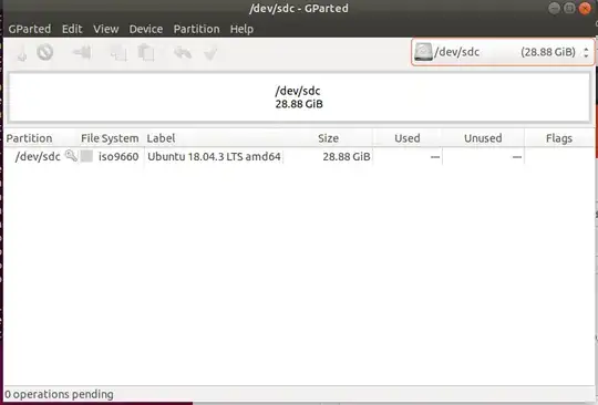

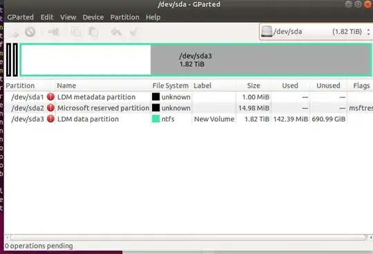

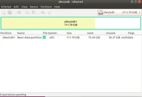

Other posted solutions have not worked, as I think something is corrupted, It feels like there are too many disks as I only used 2 disks, and the 2TB is completely new and haven't been touched. becase I may chose a wrong disk partition to boot from? I'm attaching all the different disks from GParted:
here is the Boot-info http://paste.ubuntu.com/p/fvN4Fcx37m/
