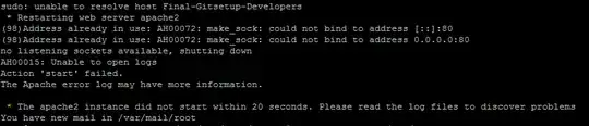

Our server [ ubuntu 14.04 ] not working, so when i tried : sudo service apache2 restart, i got :

I am not getting what next thing i need to do ?
Looks like nginx is listening to port 80,you should stop nginx with this command sudo service nginx stopand start apache after.
Edit: after short discussion we figured out the problem was in: wrong config in /etc/hosts and running nginx server. everything fixed after moving apache to another port and adding correct hostname in hosts file.

Into the report of sudo service apache2 restart I can see two problems. The first one is the message sudo: unable to resolve host <host-name>. Probably the solution of that is here: When I run a sudo command it says unable to resolve host.
The second one as @AsenM noticed is that some other service (nginx) is listen to the port 80: make_sock: could not bind to address: ...:80. Usually you can use the command sudo lsof -i -n -P to investigate which service on which port listen.
