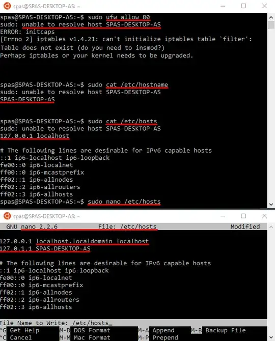

I want to install LAMP in Ubuntu. I have installed Apache. After the command sudo ufw allow in "Apache Full" it shows "unable to resolve host". How can I solve this?
To resolvethe host just add it to /etc/hosts, like at the example:
Resolve Host
For more details read this answer.

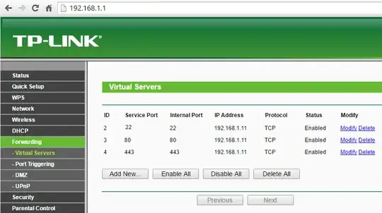

If you have a router and you want your web server to be accessible from outside, don’t forget to add some port forwarding. Something like that:
Port Forwarding
