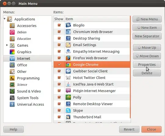

So, open alarcarte and click on the 'Properties' option of Google Chrome.

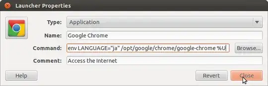

Then, replace the existing command with the following:
env LANGUAGE="ja" /opt/google/chrome/google-chrome %U
After modifying it, pin it to your launcher and from now, Google Chrome would be in Japanese.
