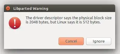

But when I use the same methods on Ubuntu 16.04 LTS, I get some warnings while formatting it afterwards.
The installation media works as expected, but when I try to format that USB stick after my work is done, I get the following warning :
The partitioning of that Pendrive looks strange :
And it also shows my 16GB pendrive as 64GB.
After struggling a lot with Gparted, I will somehow format it. But Why is it happening like this ?? Is there any better methods of creating bootable Ubuntu in 16.04 ?

Here's how I solved the problem of getting this error when trying to reformat a USB after using it as installation media:
  • First open the Disks Application under Applications > Disks
  • Select the bootable pen drive.
  • There will be an option menu on top right corner
  • Select the Format drive option (CTRL + F)
  • A pop-up will be shown. Select 0 partition and format the disk
  • Now the disk will be empty but it will be not recognized by system. But you can see on Disks Application.
  • Select the pen drive and re-format it. Now the pendrive can be detect by any system.
The accepted answer is too complex to use, as it required lots of typing and remembering the particular disk name (otherwise you may end up with serious problem). Mine is super easy to implement.

It is found that the problem is due to a bug in usb-creator-gtk. It is setting improper block-size during the creation of bootable media.
If this bug affects you, you can mark it here : https://bugs.launchpad.net/ubuntu/+source/usb-creator/+bug/1589028

The complaint about block size was probably caused by a bug in the software reading the iso9660 file system. A new version of gparted is released and is available at least in Ubuntu 17.10, where this bug is squashed.

It is a shame that many of these GUI disk utilities won't just allow you to delete the partition table off the USB, instead of just prompting with stupid errors like:
Physical block size is 2048 bytes, but Linux says it is 512 bytes
That error dialog should be coupled with this question:
Would you like delete the partition table on this device (all data will be lost)?
Since it doesn't do this, you can immediately do it yourself with this command:

Apparently the error lies with parted reading the drive incorrectly and not the dd command or the Startup Disk Creator program
Debian Bug report for parted: https://bugs.debian.org/cgi-bin/bugreport.cgi?bug=788808
Workaround: If you use fdisk instead of parted then you will see the correct partitioning. Use fdisk instead of parted until the parted bug is fixed.
