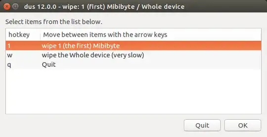

mkusb wraps a safety belt around dd
mkusb provides a graphical user interface with checkpoints to help you identify the target drive and double-check that you are wiping the correct drive.
There are menu options to wipe the first megabyte (actually mibibyte), which is usually enough, or the whole drive, which is a slow process, and useful only in special cases, for example when a pendrive is getting slow (for example less than half of the original speed.)
See these links for details how to install and use mkusb version 12 alias mkusb-dus.
