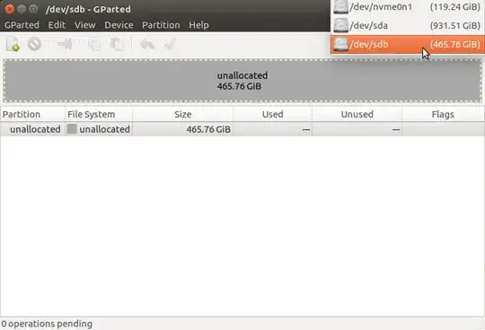

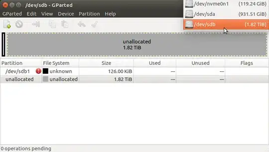

My best guess is that I messed up something while using GParted, or while creating a bootable drive. Though I can still see it in GParted, but for some reason it now shows that it has 1,82 TiB?

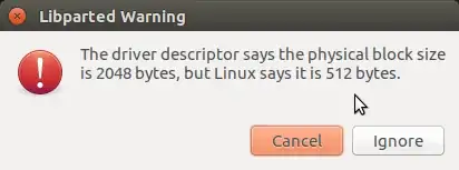

I tried to delete the unknown Partition, but it did not work, plus I get some strange warning

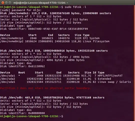

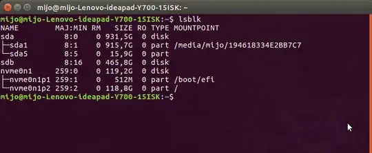

I used different commands in terminal in order to see what was going on,This is what I got.NOTE:( My laptop has single internal 128GB SSD and 1TB internal HDD.)
And for fdisk -l enter image description here

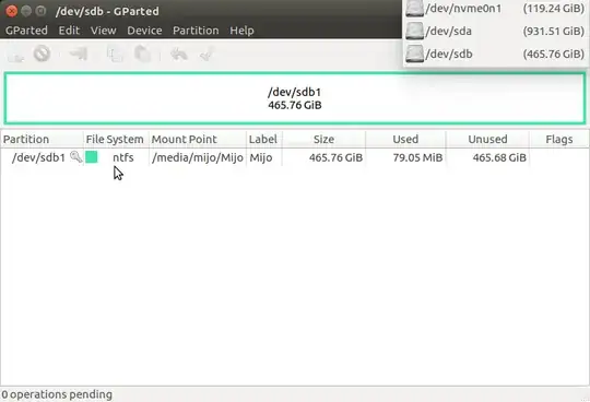

I went out (exited) of the Terminal and entered GParted... And FINALLY that "unknown" Partition was deleted,, and my Hard drive was showing the right size.. as you can see on the screen-shot below enter image description here
Then I just used GParted to create a new Partition. enter image description here
Only problem is that now it is a read-only HDD, but I bypass that by using $ sudo nautilus

This is assuming that the error of having a Physical block size of 2048 but Linux reporting 512 shows up like in your case and mine. I do this because sometimes doing fdisk (or cfdisk, gdisk, etc..) fails when trying to delete the partition or simply does not save it.
